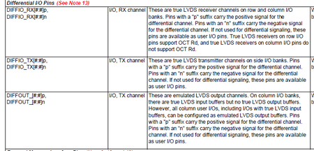

as the photo shows,I want know can DIFFOUT configured as LVDS input?

When designing the board, I connected the input signal to DIFFIO_TX and DIFFIO RX, and finally observed that B has a signal, and DIFFIO_TX has no signal. So I wonder if DIFFIO_TX can be configured as LVDS INPUT like DIFFIO RX, through primitives or other way.

Yes, since these pins are available as user I/O pins.
