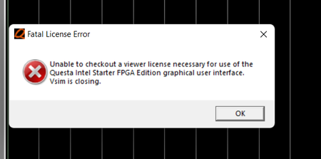

4 years agoSimulation not working in Intel Quartus Prime (Questasim unable to checkout license)
As I try to run simulation using RTL in Intel Quartus Prime, I get an error complaining about a license problem. I already had questasim installed which works fine but when it is opened throug...

Welcome to Intel forum. May we know Quartus version you use?
And could you help re-confirm your environment variable setup again? You need to set your LM_LICENSE_FILE environment variable to point to the license that Intel provides. c:\intel\license.dat or something similar.
You can refer to link on how to set environment variable.
To make this entry, you may perform a windows Search for "System Variables" and then click on "Edit the System Environment Variables" and then click "Environment Variables". Be aware that you must add the entry in System variables, not user variables.
https://www.intel.com/content/www/us/en/docs/programmable/683472/21-4/environment-variables.html
Specifying the License for the Questa
