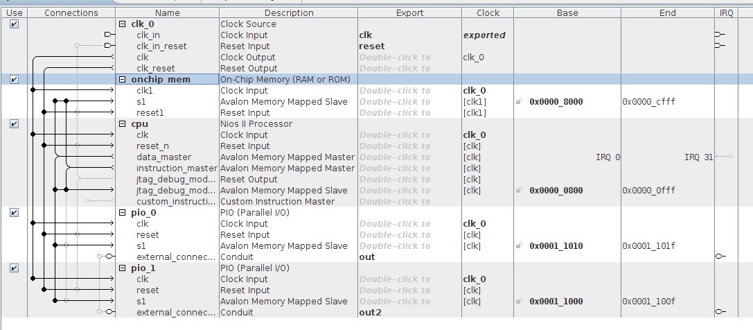

qsys system
  • A picture is attached. But basically it includes:
  • A NIOS2 standard processor with cache and level 1 debugging.
  • An on-chip 20KB memory for NIOS data/instructions
  • The memory is initialized to the .hex file that was built by Eclipse SBT and stored in the synthesis folder (I have tried both automatic initialization, and custom by pointing directly to the .hex file)
  • Two 1-bit PIO output ports that reset to 0.
  • Simulation and synthesis files are generated.
