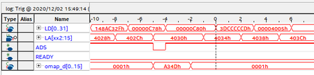

signaltap state trigger false positive
- 5 years ago
I dropped this back to a simpler filter and got it to work
Condition 1 : data = 3dcccccdh
Condition 2: address = 403xh
Condition 4: address = 683xh
Trigger on Condition1 && !Condition 2 && !Condition3=4
This won't catch a 4 byte data shift but it will catch an 8 byte or larger shift. That works for now.
Thanks for all your help.
You're looking for a repeating trigger condition, so I think a much easier way to do this would be either with storage qualification or using a segmented buffer. And you don't need to use a state-based trigger.
With a segmented buffer, you can simply set a single trigger condition to look for the appropriate LD value. Every time that value is seen, it will trigger and fill a segment of the buffer. You set the size of the overall buffer and the number of segments to divide it into evenly sized segments in the Signal Configuration section on the right side of the .stp file window. I don't know how many times you are expecting (or not expecting) to see that LD value, but if all the segments don't get filled, just stop the logic analyzer to see the segments that were filled.
Or you could use the conditional storage qualifier. Again, set a single trigger condition for the desired LD value and set the storage qualification option to Conditional. This will add an extra column in the Node list. Set the condition to be the same LD value. Now the logic analyzer will trigger when it first sees the LD value, capturing any samples with that value, and then it will continue to capture only future samples with the appropriate LD value.
The segmented buffer might be the better option because based on the trigger position, it will capture samples before and after the trigger whereas the storage qualifier will only capture samples with the matching LD value. You could try playing around with a Start/Stop storage qualifier to try to capture samples around the matching LD value.
As to why you're getting the false positive with the state-based trigger you have, I'm not sure. It looks correct to me.
Thanks for the response. Under normal operation I'm getting a trigger every 1 ms, and I have to collect data for many hours before the error occurs, and it sometimes occurs for a few seconds, then recovers for a few seconds, then occurs again... It seems like with your technique i would need a 2nd level of filter to throw out the normal triggers or stop collecting after I get a trigger on an abnormal address. That especially doesn't help because currently i can only capture 512 cycles of my SignalTap clock; I could maybe break that down to about 32 segments of 16-cycles each.
You may have pointed me in the right direction though. I had set my 'storage qualifier' to state-based, but missed that there was a 'Trigger flow control' down below that was still set to 'continuous'. I changed that to 'State-based'. Unfortunately now when I compile I get these cryptic error messages:

Any clue where I go from here?
- sstrell5 years ago
No, that's the beauty of the segmented buffer. Just let it sit and every time the trigger occurs, one segment fills, even if it's hours between the trigger events happening. You could certainly add a second trigger condition for further filtering if necessary.
As you found, state-based can be set for the trigger flow itself and for storage qualification, which I've always found weird because with a state-based trigger, you can selectively choose exactly which samples you want to capture. In any case, I don't know if that's what's causing the error, but if you want to use the state-based trigger, set the storage qualification to Continuous and the trigger flow to state-based. You can also use a segmented buffer with the state-based trigger by using the segment_trigger command in the "code" instead of just "trigger."

Thanks. it looks like when I had 'Storage Qualifier' set to 'state-based' and Trigger set to 'state-based' it caused the errors causing SignalTap to not be instantiated. At least I can compile again.
Now back to debugging this flaky trigger...
