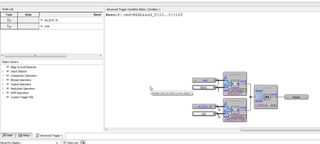

Well, at the very least, this is a runtime configurable option (all white fields in the advanced trigger GUI are), meaning you can change the equal to greater than during debugging without having to recompile the design, so you don't have to cancel your current compilation if you see this weirdness.
As for why this keeps happening, I don't think this is an issue with the older version of the software because this feature has been there forever. I'd probably create a new .stp file. Perhaps your current file is corrupted somehow.
Hi Paul,
From your side, I will suggest you to use latest Quartus Prime that support your device for testing purposes and see if there is the same issue persist and let me know. The reason is because for oldest version, Intel planning to obsolete it in the future, thus it is unlikely we will put any fix for this. After get the confirmation, mostly it will just go with an errata/known issue.
I am sorry for the inconvenience caused.
