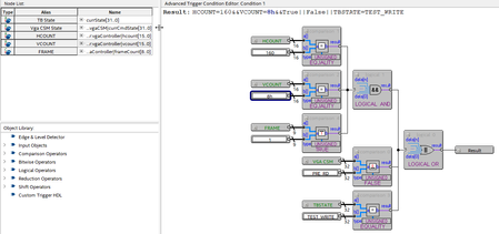

I spent ages fiddling around yesterday - removing logic from the advanced trigger and it wouldn't work. I tried changing both radix on the input object, radix on the bus display (although I doubt that was relate at all). I even tried signed/unsigned and greater than/less than comparisons but nothing would work.
It wasn't until I removed VCOUNT from the Node List and added it back that it began to work.
I doubt this is the issue (because that would be a weird bug), but have you tried using the same radix for the comparisons, instead of using decimal for HCOUNT and hex for VCOUNT? You should be able to change that without having to recompile (the white boxes in the editor).
Also try taking FRAME out of the picture temporarily to see if just the HCOUNT and VCOUNT comparisons work correctly on their own.
