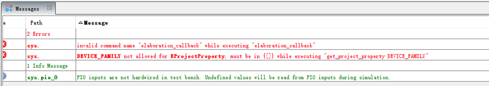

Try to use command 'get_project_property' instead of 'get_parameter_value'. The error still persist?
Sheng
p/s: If any answer from the community or Intel support are helpful, please feel free to give Kudos.- ShengN_altera
Invalid command name ''elaboration_callback'' most probably due to not being enabled. Should be first enabled with - set_module_property ELABORATION_CALLBACK elaboration_callback. Can refer manual below page 26.

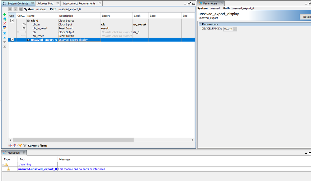

Dear,
I've confirmed that "elaboration_callback" is enableed.The format of my script is similar to the example in the manual below page 26."get_project_property" work not well.I want to get fpga device by tcl script.
