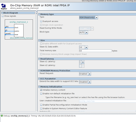

I have checked it using simple ram IP with memory size of 32 bytes of 8 bits data width & memory initialization as shown in image.
Can you share your design?
Anand

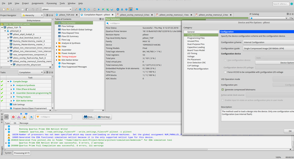

- RRomano0017 years ago
Contributor
Anand, I have to say You are right on this, I try'd a simple bench and I am able too init ram and rom, I inferred you are on Win platform, I seen a C:\ hardwired orror and long time to produce assemble file than few second...
Here simple (Succesful design) and screenshot, I now revert to large design and see if can use there a small IP parameter rom core.
Test on rom, ram single port, dual port too, so no question on basic IP Core, I fear about another interaction to plague large design as If Then Elsif fail.
Intermixed single dual port ram with different port size, imported core where intend to be attached on large project doesn't fail.
No issue here, this is another point to add to sensitivity list on the failing designs... Set again init ram to Ethernet project same issue I reported here. No idea how to fire this on simple design same as If then elsif.
Imported Ethernet, Avalon DMA Sequencer, STM32 SPI interface, no way to reproduce issue, I take some time to inspect design, I cannot share, so I am in touch with Ktan9.
