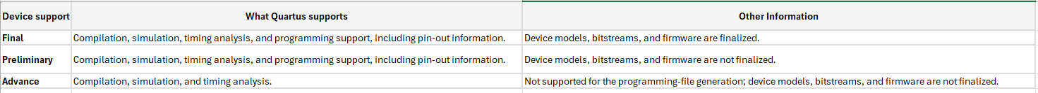

Device support in newer Quartus releases is introduced progressively and classified as Advanced, Preliminary, or Final support.
I have added with the table of comparison between them for extra clairification.
Thank you.Regards,
