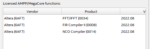

I have just installed quartus prime standard 21.1 and am trying to use Questa Sim. I have downloaded the license and pointed to it in my environmental variables per the previous advice for this. I do not see it as one of the chosen licenses I only have:
I have a quartus license and have generated the other license. Also I am using a computer on a companion license to my primary machine.
