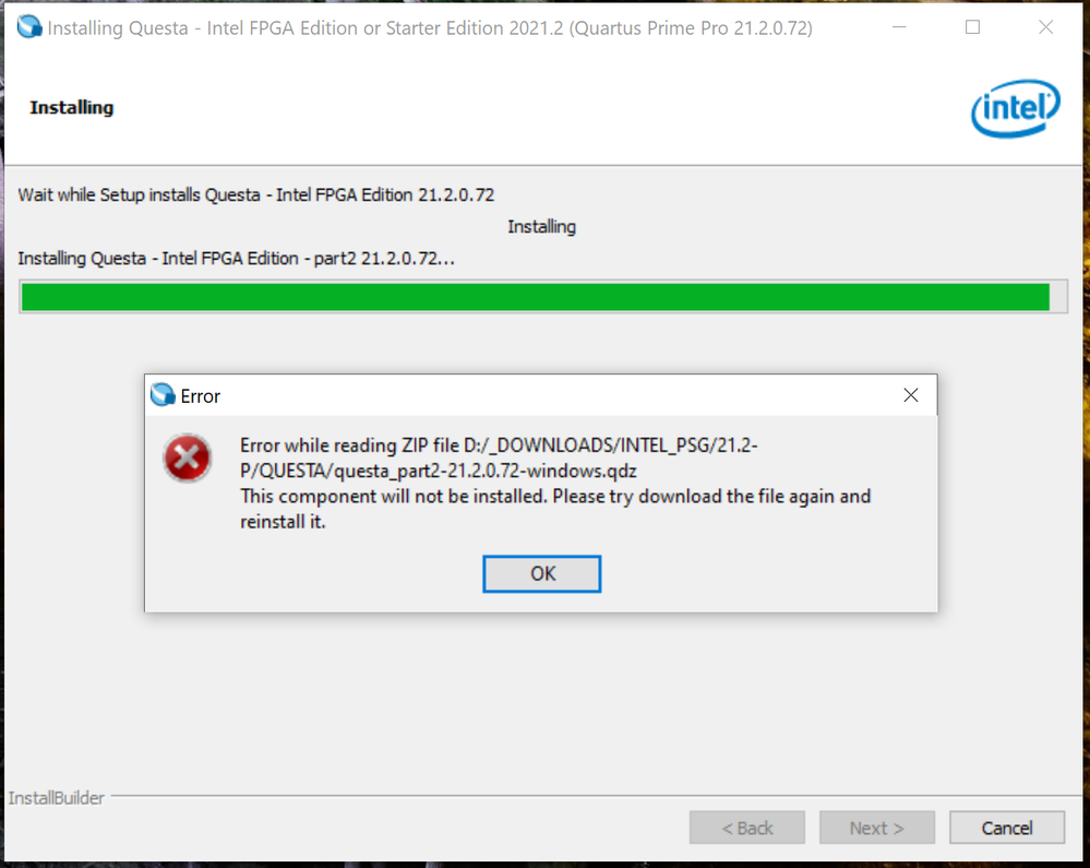

Questa Intel FPGA edition Installation
Questa Intel FPGA edition Installation failed -
questa_part2-21.2.0.72-windows.qdz file corrupted -
the installer program cannot open it.
New download does not solve the problem.
Please help.

      Correct, Quartus Prime Pro 21.2.
      Computer properties:
      Processor Intel(R) Core(TM) i7-8700K CPU @ 3.70GHz 3.70 GHz
      Installed RAM 32.0 GB (31.9 GB usable)
      Device ID 1070AA84-6CDE-4867-8B33-3BE254EE9131
      Product ID 00331-20000-00000-AA109
      System type 64-bit operating system, x64-based processor.
      (Widows 10)
      Screenshot:

    Hi Elit,
    Thank you for the clarification. I've reported this problem to our internal team, I'll let you know if there are any updates.

    Hi Elit,
    Can you download it again? Try clear cache before downloading or maybe try a different browser.
    Nurina
    • Elit's avatar
      Elit
      Hi Nurina,
      I was able to download not corrupted file, but only on a different computer with Internet Explorer,
      not Google Chrome and not Microsoft Edge (Chromium).
