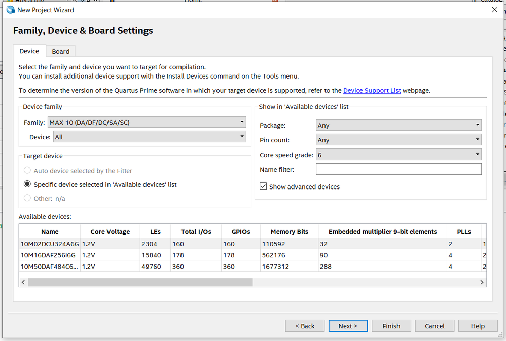

It looks like support for I6 has been permanently enabled in later versions of Quartus. Here is a screenshot of version 20.1.1
Sergio
