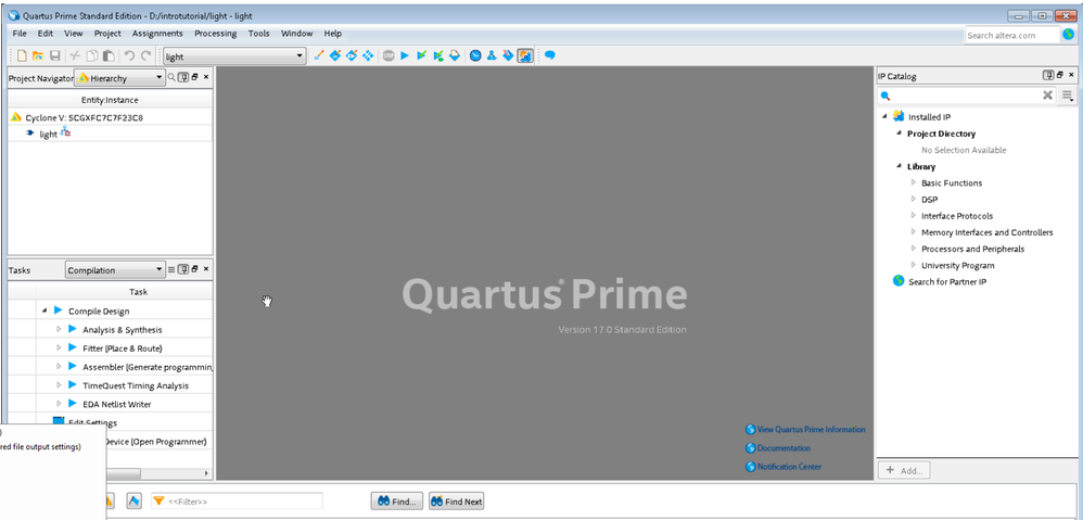

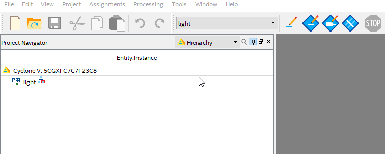

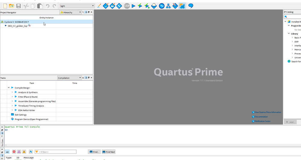

I am following the instruction of the tutorial on how to to start a project. However, whenever I arrive at the page 10 where , point 5 where I select the board , I get a different naming in the Hierarchy tab:
here is from my Quartus Prime Standard :
Here is the tutorial:
I have named the same top-level Project and it is light.

- TarikTec
I put the name light in the board tab. but when I changed it to Device, it showed like in the tutorial.
- Nurina
You can also change this in Assignments->Settings->General and enter "light " in Top-Level Entity. I take that your problem has been solved and I shall put this to a close pending. Please post a response in the next 15 days to allow me to continue to support you. After 15 days, this thread will be transitioned to community support. The community users will be able to help you with your follow-up questions.

- TarikTec
Yes, I entered light but I choose board and not Device
