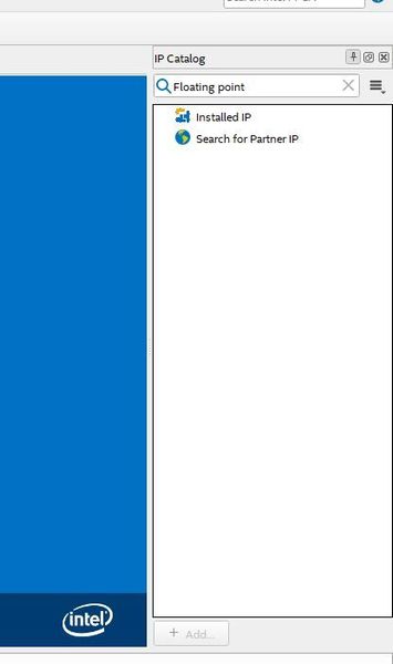

Hi everyone, I'm having this weird issue that the Quartus Prime Pro 18.0 is not working in Windows 10. I have download the full package, including device support (Stratix 10, Arria 10) and installed...
