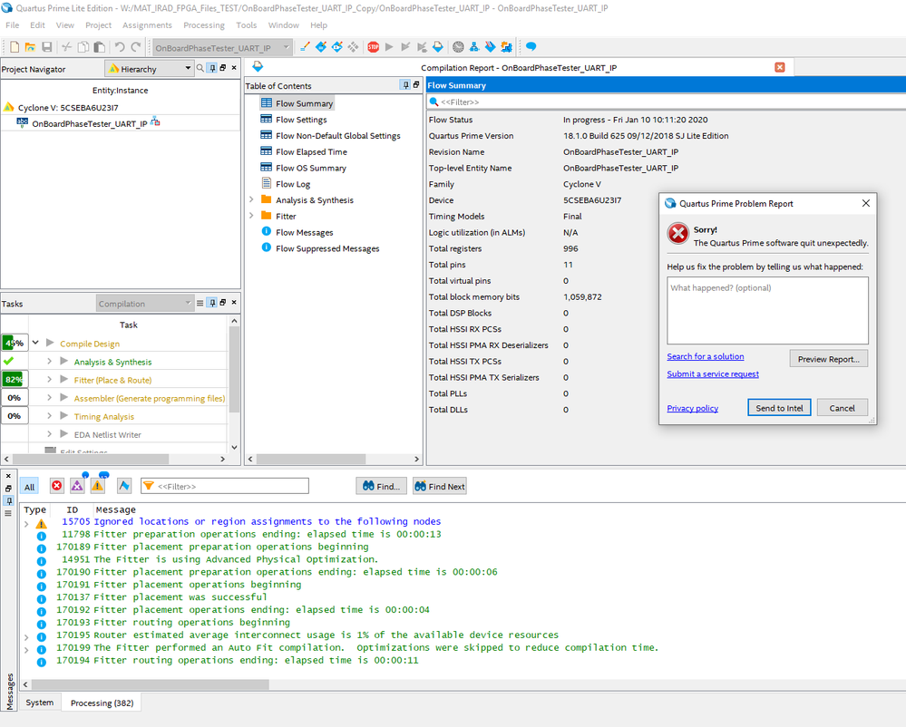

Quartus Prime Lite Quitting Unexpectedly During Fitter

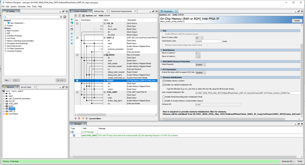

I was able to get the project to compile after decreasing the total memory size in the On-chip Memory IP in platform designer. I decreased the memory from about 130000 bytes to 100000 bytes and this seemed to work.

- VROGE26 years ago
I had already tried to delete the db folder but I had not tried to delete the incremental _db folder. I did make some changes in the platform designer in the on chip memory IP. The changes were that I changed the name of the IP's in the platform designer to follow the Max Baud Rate Cyclone V SOC Design Example and I changed the On chip memory initialization so that it does not initialize memory content. this allowed the program to compile but It does not allow for the use of the nios ii code I am using.

- VROGE26 years ago
I have gotten approval and have modified my original code to replace the proprietary sections with a counter. I still get the same error during the compilation

- VROGE26 years ago
With that same project I still get the same error as shown below. To be sure I re downloaded the project from the file I posted above. I have deleted the db and incremental_db and I have tried compiling with no other programs running in the background. The only thing that I have been able to do to stop this error from happening is to comment out line 18 in the top level V file or to go into the platform designer in the on chip memory module under memory initialization and un-check "Enable non-default initialization file" and "Initialize memory content". My assumption is that in order for the UART IP to work I need those two boxes to be checked. Is that assumption correct? Could there be any potential problems in where I have it saved or possibly my compilation settings as well? We are running the same version of quartus.
