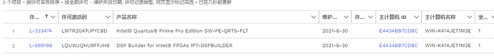

All license in self-service licensing center:

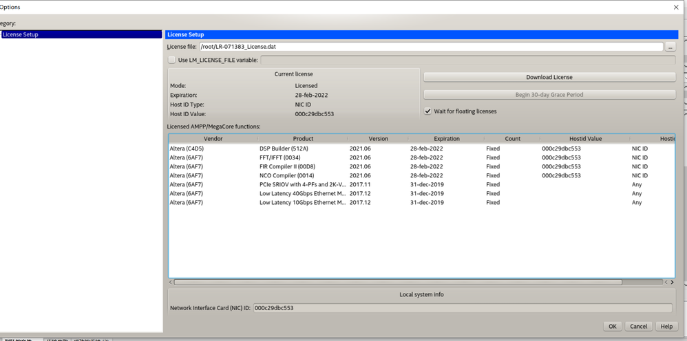

I generate an license from self-service license center, and upload to Quartus License Setup, which shows like the figure below:
My question:
1、In the figure above, why the expriration time of the last three product end up on 2019 year after I upload a new license file?
2、Why my license can not support our PAC with Arria 10 GX FPGA? Did I purchase wrong license product, which is the correct one?

Form you license I could see that the license type is FIX but Quartus Pro is Floating type. Can you confirm this with distributor that you purchase this license? if you are using fix license it should be Quartus fix license also
- wgshnyhlw
Thanks. Considering we use Intel Acceleration Stack for Intel Xeon CPU with FPGAs 1.2 version. Now we plan to purchase the permanent license of the three product shows in the picture below. Should we purchase float type or fix type license for the Quartus Pro bundled in Acceleration stack?
I noticed that the license of acceleration stack can be upload with a License Patch, which need CNDA account to sign in. But the local sales have no idea about this resource as well. They cannot find the License Patch for Intel Acceleration Stack v1.2 for Intel FPGA PAC with Intel Arria 10 GX.
So, I would like to confirm that if I cannot got the resource of License Patch, can I purchase IP core and PCIe license separately so that Quartus tools in the acceleration stack can run correctly? And which type of license should I purchase, float or fix?
