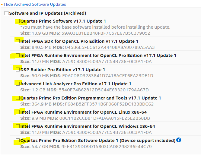

Could you try to install the updates individually like what you did when you install the software?
- YRose3
- KhaiChein_Y_Intel
Can you install the following updates individually?
aocl-pro-rte-17.1.1.273-linux.run
AOCLProSetup-17.1.1.273-linux.run
DSPBuilderProSetup-17.1.1.273-linux.run
ModelSimProSetup-17.1.1.273-linux.run
QuartusProProgrammerSetup-17.1.1.273-linux.run
etc
- YRose3
OK.
So, that was a good suggestion.
I think it is 90% OK now.
- I can not install the DSPBuilderProSetup-17.1.1.273-linux.run as it complains that I am not in the correct version.
- when I check in the "about" of the Quartus, it says that it is version 17.1.0
thanks
- YRose3
Hello KYeoh ,
OK.
I reinstalled the 17.1.1 upgrade with success.
it looks 100% OK now (DSP installed + "about" is 17.1.1)
