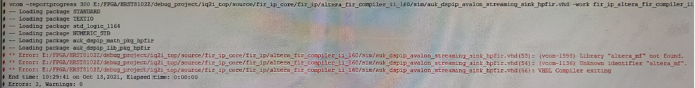

Quartus co-simulation modelSim FIR problem
Hello seniors
The software I use is Quartus 16.0 standard edition, and ModelSim uses third-party software, version 10.6D
I used Quartus to combine the simulation with ModelSim. The following errors occurred when ModelSim was compiling FIR library, which could not be solved. I request your help

    Hi PP,
    Can you repost the snapshot with clear error message if possible? The attachment is almost unreadable.
  • pp's avatar
    pp
    This error says "AlterA_MF" not found,it means the fir ip some files not found the library "AlterA_MF"
  • SyafieqS's avatar
    SyafieqS
    1. Make sure the IP files are in the project
    2. Remove and add again the ip file to see if able to read
    3. Regenerate the IPs.
