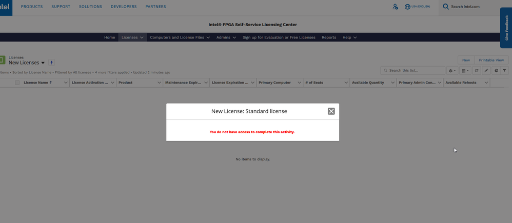

    Now i have installed Quartus 20 and the Software Dongle appears. How can i generate the license file at Intel FPGA Self-Service Licensing Center? I wasn't able until now. It is a unused Guard Dongle. Is the license portable to a other computer if my current computer break down?

    Could you provide details for checking
    Name :
    Email Address :
    Company Name :
    Company Address :
    NICID(Mac Add) :
    Dongle Guard ID:
    For privacy, reply/attach file in private message.
