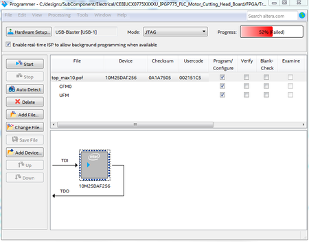

Quartus 18.1 not programming .pof file. .sof file works fine. Says it passes if I don't enable real-time ISP but it doesn't work. Fails if I enable real time ISP.
Hi ADelp,
Can you provide the error message log in the Quartus programmer when the .pof file programming failed? The screen shot does not show any error message apart from the progress bar failed at 52%.
If you are using Dual Compressed mode in your project design with the Dual Boot IP, then only you can generate the .pof file containing 2 compressed images for CFM0 and CFM1/2 respectively. Otherwise if you are using Single Compress/Uncompressed mode, then you can only generate a .pof file with 1 image for CFM0. This is already shown under "Figure 2. Configuration Flash Memory Sectors Utilization for all Intel MAX 10" from the MAX 10 Configuration User Guide in the following link:
