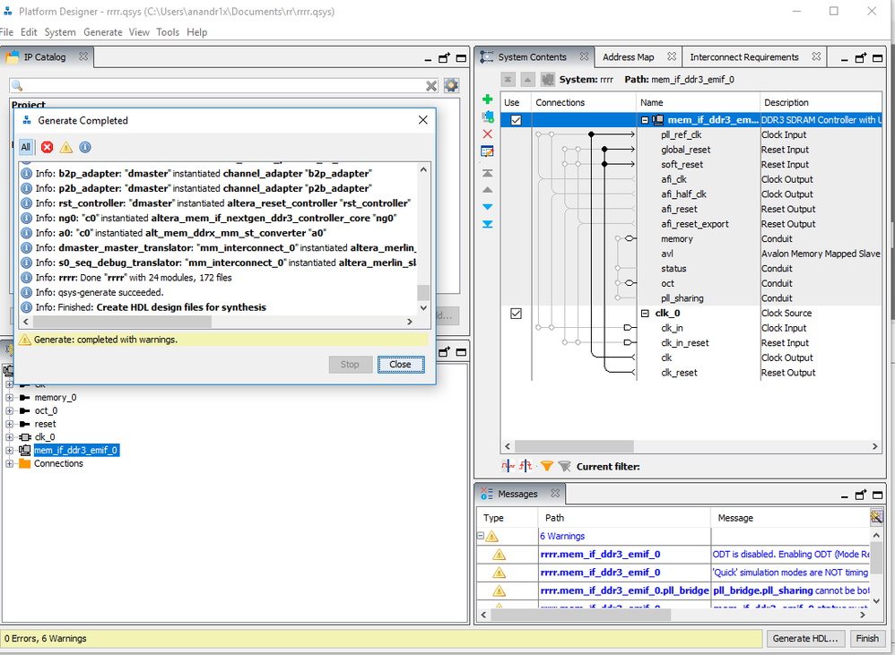

    Sorry for the late response.
    We have used Quarts 17.1 lite in windows 10 environment.
    1. Used Clock Source and DDR3 IP’s only.
    It was successful generated.
    Can you try to recreating the project or by deleting the db folder.

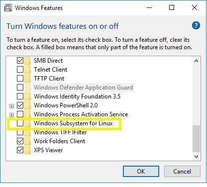

  • AnandRaj_S_Intel's avatar
    AnandRaj_S_Intel
    ​Hi,
    The above scenario will be fixed by disabling one of the Windows feature as highlighted below “Windows Subsystem for Linux”.
    Anand Raj Shankar
