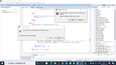

mark_leeOccasional Contributor5 years agoquartue prime 19.2 cannot running “nios software build tool for eclipse ” I am trying to get the NIOS II SBT for Eclipse to work with Quartus 19.2,when run the Eclipse i am get an error as this : Show More
EricMunYew_C_IntelFrequent Contributor5 years agocan you try to download the patch from below KDB:https://www.intel.com/content/altera-www/global/en_us/index/support/support-resources/knowledge-base/embedded/2020/nios2-elf-gcc-exe--error--createprocess--no-such-file-or-directo.html
