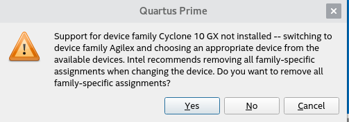

project_new -family Agilex detected as Cyclone 10 GX
project_new agilex_r29a -overwrite -family Agilex
Why Cyclone 10 GX?
"-family Agilex" is requested

    So you're trying to target Agilex and it wants to use Cyclone 10 GX? Can you successfully set up a new project like this with the New Project Wizard instead of a command?
  • Not at all, I don't even know from where Quartus takes the Cyclone 10 GX...
    As anybody can see, there is no mention of Cyclone in the command, only agilex.
    What's wrong with my command?

      Understood, but as a test, can you successfully create a new project with Agilex using the New Project Wizard instead of a command?
      • alexislms's avatar
        alexislms
        Yes, no problem from the wizard.
        You can easily reproduce it by opening quartus and running my single line command.

    Alternatively you can use global assignment to set the device family in tcl script
    set_global_assignment -name family AGILEX
