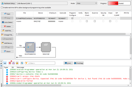

5 years agoProgrammer fails at 45%, JTAG ID suddenly 0x00000000
I'm encountering a weird issue when trying to program my Cyclone V GT FPGA Development Board.
I have generated my .sof file, and I am attempting to upload it. The programmer identifies the FPGA and...
sstrell
5 years agoIt could just be a bad file. Maybe you can just rerun the Assembler and generate a new file. If it still doesn't work, I'd try a full recompile.
