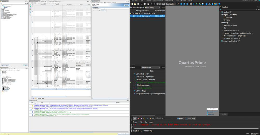

*screenshot*
[image: screenshot.png]
The left half of the screen shows the platform designer. Icons and texts on
the console are extremely small. The right half is the quartus software. It
is still displayed correctly. I started the platform designer from quartus.
