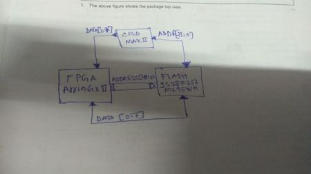

I am trying to configure EP2AGX Arria® II GX using EPM240 Max ii CPLD and on board CFI Flash js28f256m29ewh using PFL IP.
In my case our custom Board flash Address bus 24bit bus...

sir i am not talking about connection between Arria fpga and flash.
I am talking about data bus between cpld max II and flash
if we doesn't have physically data bus between Max II and flash how pfl will work?
