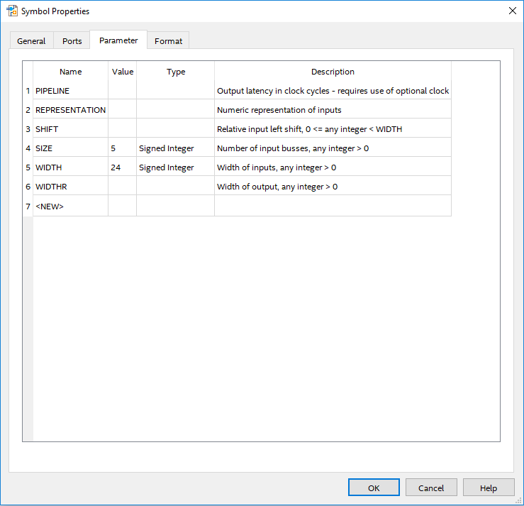

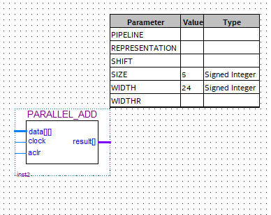

- RNeto2
Like so? Because even when I alter the size and width, there's no actual change in the look of the block. I figured maybe due to the fact that I'm using the Lite Edition?
- sstrell
Yes, but I think you have to refresh the block symbol you've already added. It's much easier to generate it as an IP from the IP Catalog and set the parameters that way.
