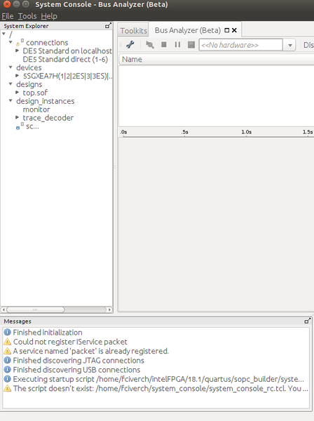

7 years agoNo hardware detected in beta bus analyzer
Dear community, I have a Terasic DE5-Net FPGA based on Stratix V FPGA. I would like to monitor the Avalon MM bus by mean of the Bus analyzer toolkit. I followed the guide of this link (https://fpgaw...
FCive
7 years agoI use the 18.1 version of Quartus and, as described in the guide, from version 14.1 "JTAG Debug Link is auto-instantiated and is not a selectable IP core from the IP Catalog".
Thus, I did not add anything in the design and I only enabled the instrumentation.
Do I have to add something else in the design?
Thank you.
Federico
