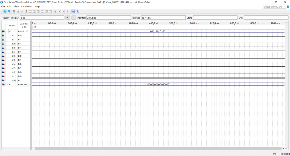

Hello, I just started on VHDL about a month ago and I'm making a base 12 to base 6 converter as a part of my school project, this is what I currently have:

end arch_R12M7A9_3digToR6_4digConv;It compiled fine but it doesn't give me the expected result, in the image I have bin set to "011110101001" (7A9) in base 12 and I expected it to return "0101000100110011" (5133) in base 6 as the output, but it gave me 0s. Any suggestion would be great, thank you :).

- Vicky1
Can you debug the signal 'd_sum10' ?
Check whether Conversion of base 12 to base 10 happening correctly...
Best Regards
