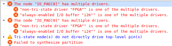

What are the exact errors you are getting? How are your partitions set up? All I/O should remain in the root partition and other partitions should include only internal logic. More detail needed here.

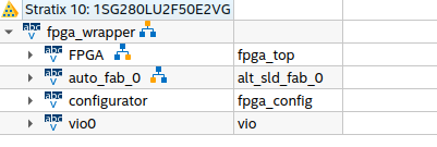

I have a partition (fpga_top) that I want use its final snapshot:
I have bidirectional pins on that partition:
I assign that bidirectional pins on top module (fpga_wrapper):
Synthesize failing in this case:
When "fpga_top" is not a partition, compilation finished successfully. Sharing .qar file.
