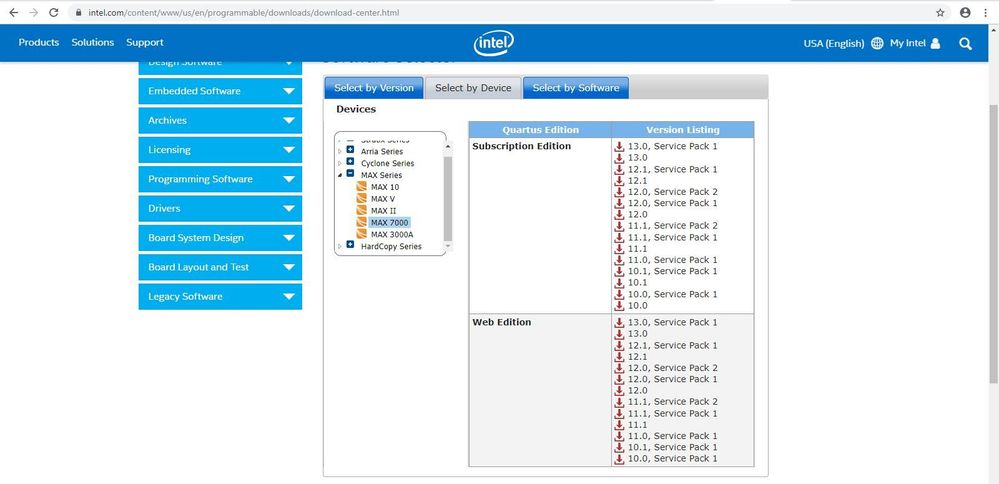

Here, for compiling & programming(MAX 7000) the EPLD EPM7128SLC84 you can install any Quartus version from 10.1 to 13.0 Web Edition as shown below,
please refer the links below,
https://www.intel.com/content/www/us/en/programmable/downloads/download-center.html
https://www.intel.com/content/www/us/en/programmable/downloads/software/service-packs/sps-web.html#90

Ok, but the last version of Quartus that supports the EPM7128S series parts is 13.0sp1
