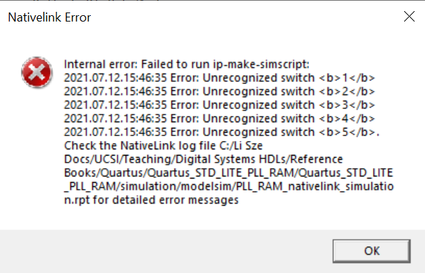

When I followed the steps in https://www.intel.com/content/www/us/en/programmable/documentation/aym1499789502823.html#myk1498083534479
I get this error when I click on Tools > Run Simulation Tool > RTL Simulation.

Does your project directory have a space in the pathname? Try changing the pathname such that there's no space in it. https://www.intel.com/content/altera-www/global/en_us/index/support/support-resources/knowledge-base/solutions/rd05272013_352.html
