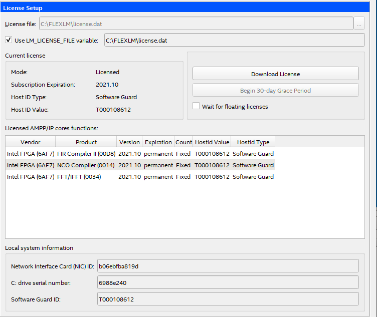

Thanks for update. Customer service team has re-generate you a new license. Could you help to try it and report back if error happen with Screenshot of error and Quartus II>>tools>>license setup.
- Elit5 years ago
Hi.
Unfortunately, nothing has changed. Modelsim Intel FPGA edition 20.3 Pro errors:
** License Issue: License request for alteramtivlog feature failed
** License Issue: No such feature exists. (C:\FLEXLM\license.dat)
** License Issue: No such feature exists. (C:\flexlm\license.dat)
** Error: Failure to obtain a Verilog simulation license. Unable to checkout any of these license features: 'alteramtivsim' or 'alteramtivlog'.
Error loading designQuarus License Setup:
