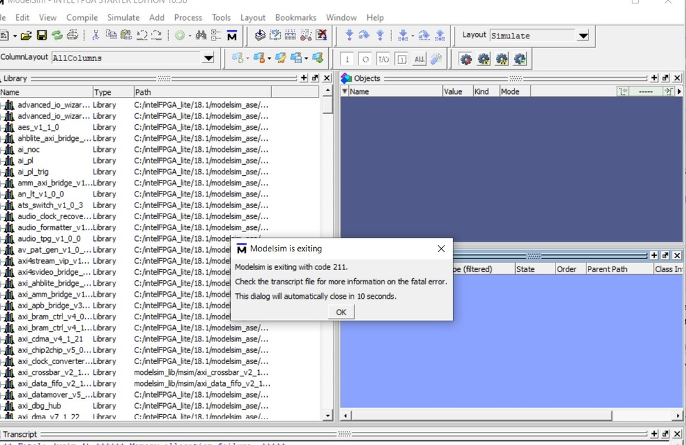

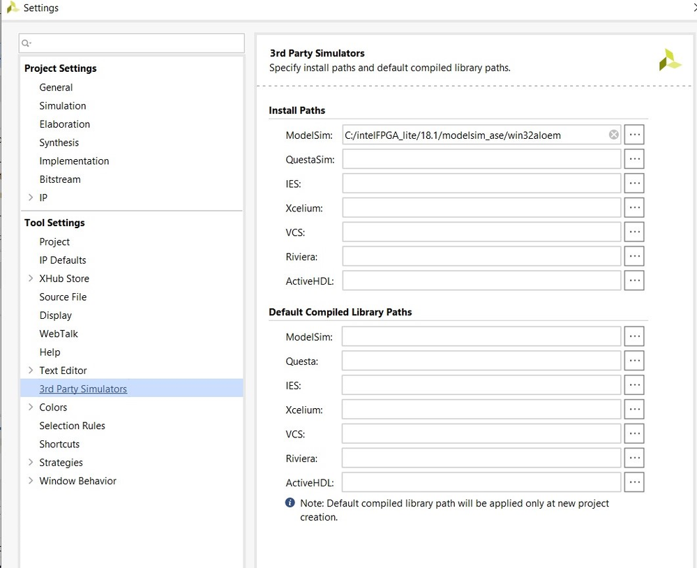

I am having trouble launching Modelsim from Xilinx Vivado 2020.1. I am using ModelSim- Intel PGA Starter Edition 10.5b (Quartus Prime 18.1). As soon as I run simulation from my Vivado 2020.1 platform, it crashes within seconds. The error code is 211, which is apparently licensing issue. But the starter edition is free version. But still get the same error. I checked on the internet where it is mentioned that it may be some design problem. I am trying a simple design but still face the same problem. Could anyone help me with the problem? Attaching the relevant screenshots for your reference.
