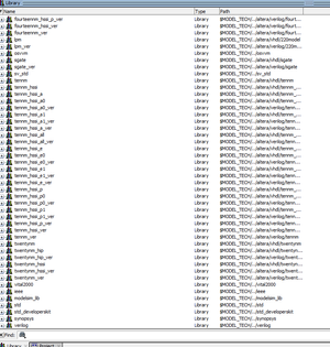

Modelsim ASE starter not directly support UVM
Hi Guys, I installed modelsim ASE starter edition 2021.02. From common knowledge, I thought this tool has pre-compiled UVM features. But after I installed, I found `include "uvm_macros.svh" cannot ...
