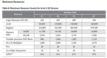

4 years agoLEs utilization reported in Quartus
How to know the LEs utilization from the Quartus report? For example, I am using Arria V GZ E7 with 450K LE(s). Quartus report only showed Logic utilization (in ALMs). How to find out the LEs ...
sstrell
4 years agoYou're looking at just the summary report. Go into the Fitter folder in the Compilation report to see much more detailed resource breakdowns. Even the Hierarchy view in the Project Navigator has more detail if you scroll it to the right.
