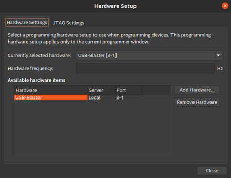

Hi
I am in the exact same position. Everything seems to install fine, the usb blaster is recognized
but programming fails with the same message.
Note that I ONLY use USB. So it both provides power to the DE10-lite board
and is also used for programming. I don't know if this is a problem. But I have found no
information on how to debug this.
Any help would be appreciated.
Morten

Ok I found out what is wrong
The problem seems to be with jtagd (jtag daemon) trying to read the shared library libudev.so.0
on my machine this is located in /lib/x86_64-linux-gnudo
> cd /lib/x86_64-linux-gnu
> ls -l | grep libudev.soIf you only have a libudev.so.1 (which is a symlink to libudev.so.1.6.17 on my machine)
> ln -s libudev.so.1.6.17 libudev.so.0
See more here how to find out if this is your problem
https://groups.google.com/g/hermes-lite/c/3dapVjw1zgE- finlay_morrison5 years ago
