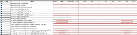

I added the Unique Chip ID Intel FPGA IP to my platform for an Arria V FPGA.
To read the Chip ID I created a custom IP with a Avalon Streaming Sink (data[63:0],valid) and split the data into ...
- 5 years ago
The problem occured due to an improper reset wich is active high for the Unique Chip ID IP. Furthermore, the timing of the reset pulse seemed to be relevant in some way.
Solution:
I apply a delayed reset pulse to the reset input of the Unique Chip ID IP which is a bit longer than the asked 10 clock cycles.

5 years agoCan you try to read the chip_id[63:0] directly after your FPGA is fully loaded and when data_valid is high.
