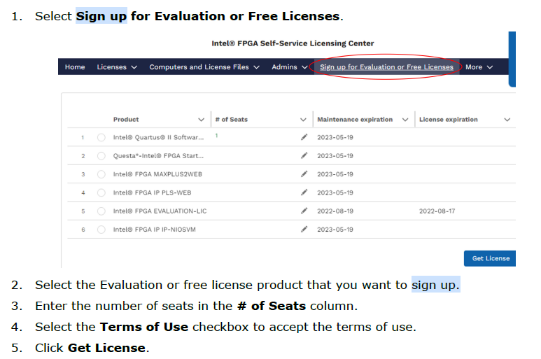

      Questa*-Intel® FPGA Starter Edition SW-QUESTA
      # of Seats = 0 => Why?

        Hi Yukai,
        For your query, "# of Seats = 0" is the default value provided and User must enter "# of Seats" as "1" to generate the license file.
        Click Generate after entering the value and license file will be sent.
