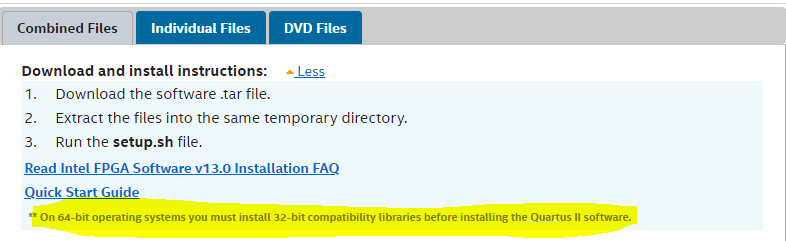

    It was mentioned in the download page, that for the Quartus II tool setup to install there needs to 32 bit libraries installed.
    Please help with the 32-bit libraries to be installed for Red hat Linux enterprise for installing Quartus II installation of 13.0.1sp

  • SDuvv's avatar
    SDuvv
    @sstrell ​Please help with the link or source to download 32-bit libraries required for Quartus II tool installation.
