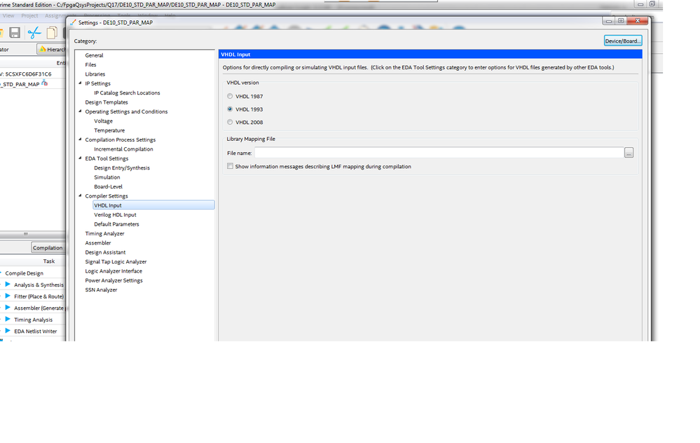

In Quartus we set the VHDL version with Settings -> Compiler Settings -> VHDL Input. How to inform the platform viewer about the VHDL version?
I am using the custom types and written those in the package. I am using them unconstrained like below
type mydatatype is array (integer range <>) of unsigned;And with the settings the VHDL version to 2008, I could analyze and synthesize in Quartus. I would like to make component with the code I have written so that can be used in the Platform Generator. So when I try to do that, I get an error
element type for array type cannot be unconstrainedHow to set the VHDL version in Platform Generator to get rid of the error?
Best Regards
5 Replies
- JOHI
Contributor
In Quartus go to Assignments / Settings
And in the settings dialog box go to Compiler Settings / Vhdl input.
Johi.
- MakV
I am already using the settings in Quartus. I want to use the same sources and make a Qsys-component.
My question was how to set the VHDL version in Platform Generator(Qsys).
