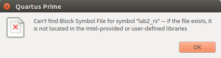

7 years agoif I symbol from my own global libraries than "Update Symbol or Block..." is not working for it
I have a folder which contains some of my symbols (bsf files). I add this folder to list of Global Libraries via Tools > Options... > General > Libraries > Global libraries (all projects). After th...
Vicky1
7 years agoHi,
'I add this folder to list of Global Libraries via Tools > Options... > General > Libraries > Global libraries (all projects).'
No issue/error occurred with above.
Could you please confirm that "lab2_rs' exit & that too appropriate location?
Vikas Jathar
VVavr1
7 years agoFor some reason I can reproduce it on my usual Windows/Linux system but I can not reproduce it on fresh Linux install.
It is hard two narrow down what is the problem. Moreover I have found another issue https://forums.intel.com/s/question/0D50P00004BqBGySAN/ that is related and blocks for narrowing down this one.
If Intel can address https://forums.intel.com/s/question/0D50P00004BqBGySAN/ than we can go back to this one.
