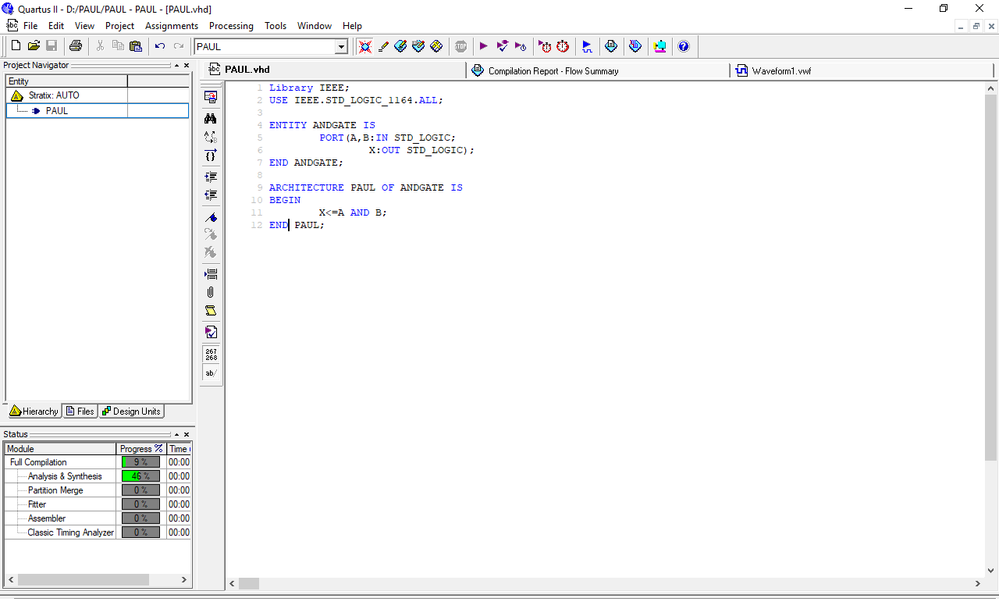

7 years agoI received this error while trying to run the program: Error: Top-level design entity "PAUL" is undefined I am using QUARTUS II Version6.1 How can I fix this?

From image i can see that your top-level design name is PAUL but your entity name is ANDGATE.
We need to have entity name and name for top-level design same. change you entity name to PAUL instead of andgate.
Example : file name top.vhd set as top level entity.
entity TOP is port ( ... ); end TOP; architecture my_design of TOP is begin ... end my_design;Let me know if this has helped resolve the issue you are facing or if you need any further assistance.

Oh thanks I saw it later after posting the Question.
