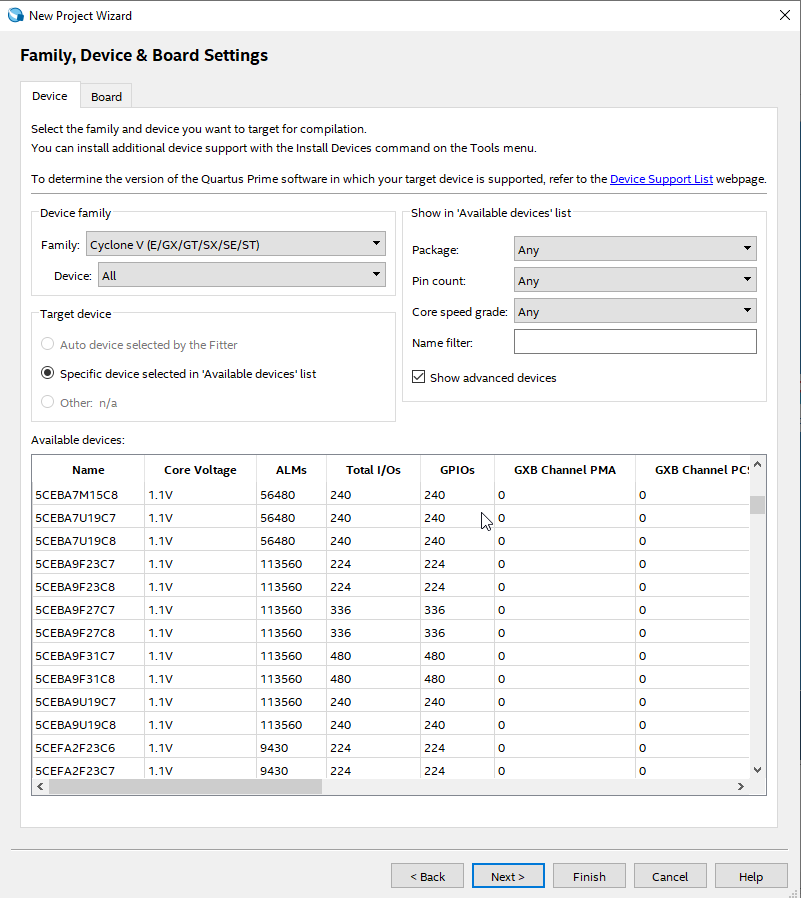

I could not find Cyclone III EP3C16F484C6N in Quartus Prime Standard for DE0 Board?

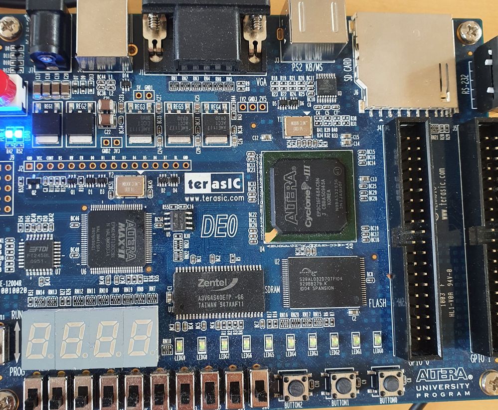

Hello, I wanted to run my first VHDL program in Quartus Prime Standard with DE0 boards that has Cyclone III EP3C16F484C6N as FPGA but I could not find it in the board selection neither in Device selection.

      Does that mean since I am using Quartos Prime Standard 17.1, I cannot run DE0 that does have Cyclone III EP3C16F484C6N as FPGA?
      P.S: I looked in the link and I could not find again Cyclone III EP3C16F484C6N.
