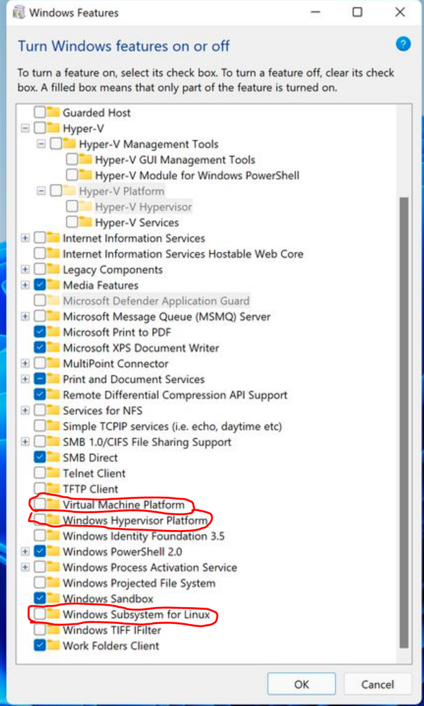

I can't program FPGA with linux command line mode
i installed ubuntu 18.04+virtualbox on my windows 10 laptop, and then installed Quartus prime pro 20.1 linux version.
with above environment, I can download the FPGA successfully via the quartus programmer tools. but when i tried below instruction in linux command line mode,
quartus_pgm -c 1 -m jtag -o "p;$SOCEDS_DEST_ROOT/examples/hardware/a10_soc_devkit_ghrd/output_files/ghrd_10as066n2.sof"
it failed and error information is as below:
Error (20910): The host CPU is not supported in this version of the Intel Quartus Prime software. Intel requires that you upgrade to a more recent processor that supports SSE 4.2 and the POPCNT instruction
so, with the same configuration and the same target board, why i can't use the command line mode?
please help me to solve it. thanks in advance.
  • after my test, to avoid above error, beow red highlighted items in windows features shall be unchecked.
    after unchecking the items, the quartus_pgm can download the sof to FPGA without error.
  • i tried again the next day, and the programming was successful. i believe i have not changed any configuration, i don't know why so.
    • Rainwang's avatar
      Rainwang
