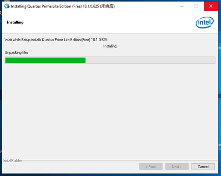

6 years agoI can't instal the Quartus prime lite on WIN10, it always fails to respond.
When installing quartus, the progress bar will get stuck in half, and then prompts no response. No more results from waiting. As shown below:

6 years agoHi,
Please check the things below,
- Quartus Lite 18.1 requires approximately 14GB of available disk space on the drive or partition where you are installing the software.
- If you are running the Bitdefender antivirus software, you should temporarily disable the software during the Quartus Prime software download and installation proc
- Always try to install the Quartus tool in empty directory or different drive with Administrator Privileges(Avoid to installed with previously installed directory)
- If still issue persists, download new fresh Quartus Installation Setup & try to install. It may get corrupted while downloading.
