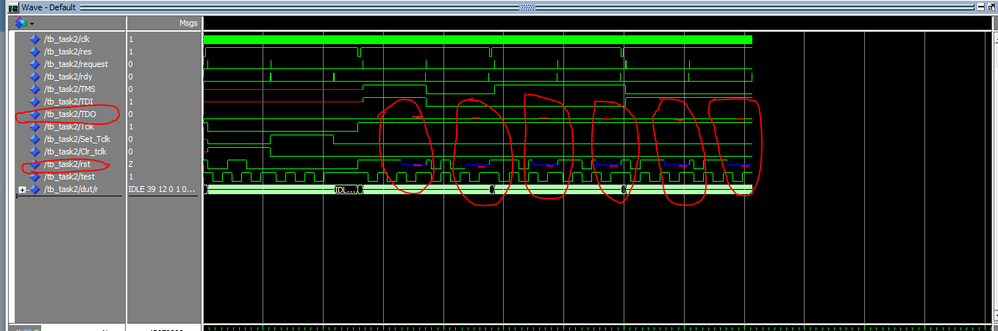

7 years agoI am working on a FPGA project.i am facing issue using a bidirectional port.
I have a rst port which is bidirectional .I want to drive rst and want its output on tdo which is an output port.i have set rst to z but how to drive the rst as an input port .i want to just edit test bench to have this behavoiur which i want to get.

Hi @FAhma9,
You may refer to https://www.intel.com/content/www/us/en/programmable/support/support-resources/design-examples/design-software/verilog/ver_bidirec.html for Verilog HDL: Bidirectional Pin.
