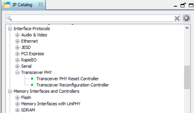

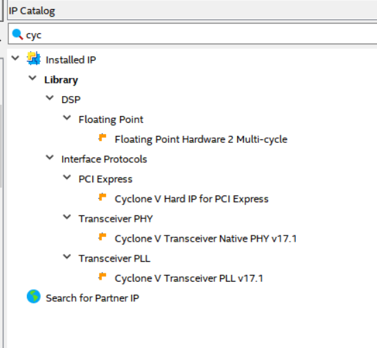

I am unable to see Cyclone V Transceiver Native PHY IP in Platform Designer whereas it's available in Quartus. It's 17.1 tool version. Attached are the snapshot for reference. How can I enable the above mentioned IP in platform designer?
Quartus
Platform Designer
- CheepinC_altera
As I understand it, you have some inquiries related to Native PHY in Platform Designer. For your information, the CV Native PHY is only available in the IP Catalog Editor. Sorry for the inconvenience. If you would like to use it in Platform Designer, you might need to look into importing it as a component to Platform Designer.
