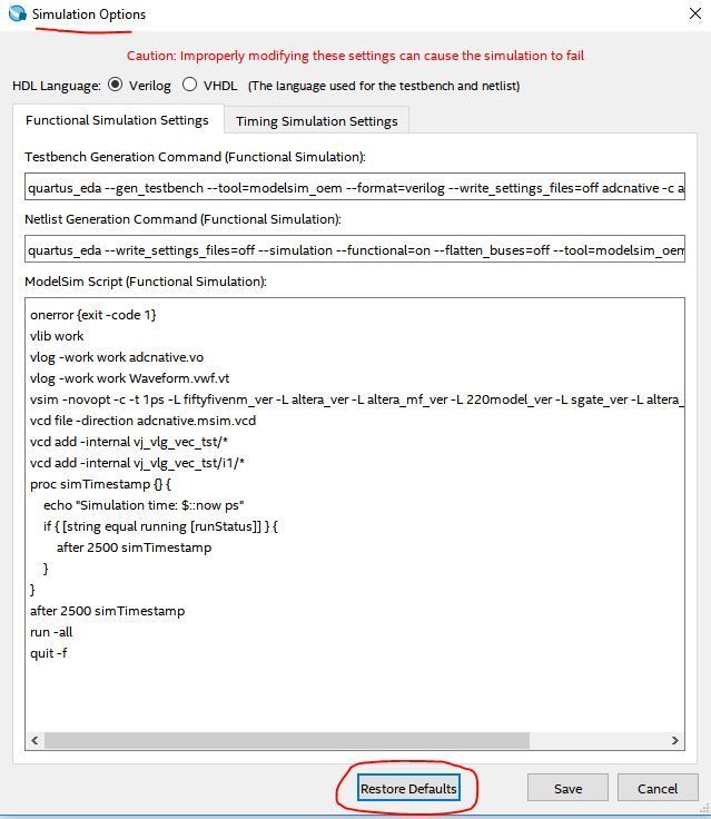

I am a noob at Quartus, please help me with the error. Thanks
Error: Waveform1.vwf.vt(30): near "1E0": syntax error, unexpected FLOATING NUMBER, expecting ')'
# ** Error: c:/users/usuario/desktop/editores/modelsim_ase/win32aloem/vlog failed.
# Executing ONERROR command at macro ./punto1decimal.do line 4
1 Reply
  • Vicky1's avatar
    Vicky1
    Use "Restore Defaults" option under "Simulation" -> "Simulation Settings" and try once again.
    Refer the below screenshot,
