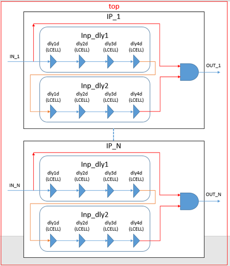

Can I ask another question?
You said that "specify the start and end point if want to check the delay between the specific LCELL."
Could I use "report_path" command twice to report the delay into the same panel?
Ex.
(1)
report_path -from [ get_pins {top|IP_1|Inp_dly1|dly1d|combout}] -to [ get_pins {top|IP_1|Inp_dly1|dly2d|data*}]
-npaths 1000 -panel_name LCELLs_delay
(2)
report_path -from [ get_pins {top|IP_1|Inp_dly1|dly2d|combout}] -to [ get_pins {top|IP_1|Inp_dly1|dly3d|data*}]
There use "report_path" command twice.
Could the second "report_path" command report the delay that append into the same "LCELLs_delay" panel, but not overwrite?
